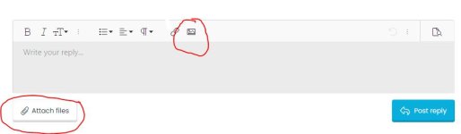

I use the Insert and the Attach option to add images to my posts

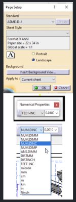

This post essentially solved my problem, because I was able to download a template (.CATDrawing file) from my company's engineering repository (PLM system) and that possessed a particular Standard, in this case ASME-D-J. When this Standard is selected, the correct number of leading and trailing zeros displays (in inch units) when a dimension is placed in the CATIA V5 R26 Drafting Workbench.
If I wanted to manually get the correct number of leading and trailing zeros (in inch units) to display in the Drafting Workbench, I had to select NUM.DINC in the Numerical Properties toolbar.
See image below for reference.
